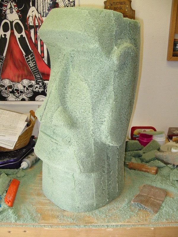

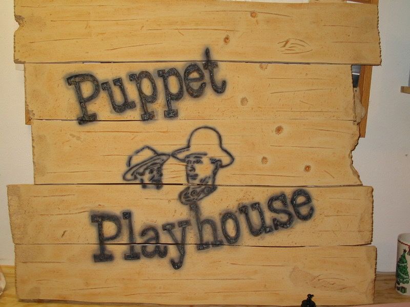

Celluclay is light, but can be messy and slow to set. If you’re looking to add rocky layers or layer up hills, I suggest a couple types of foam. First floral foam:
Sculpting:
http://i2.photobucket.com/albums/y28/s_hasty/IMG_2626.jpg
Complete:
http://i2.photobucket.com/albums/y28/s_hasty/IMG_2796.jpg
It's porous, so it's great for lava-type rock.

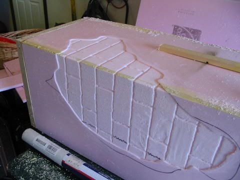

Now, pink or blue sheet insulation (same stuff, different color):
Raw foam under construction:
http://i2.photobucket.com/albums/y28/s_hasty/e22b.jpg

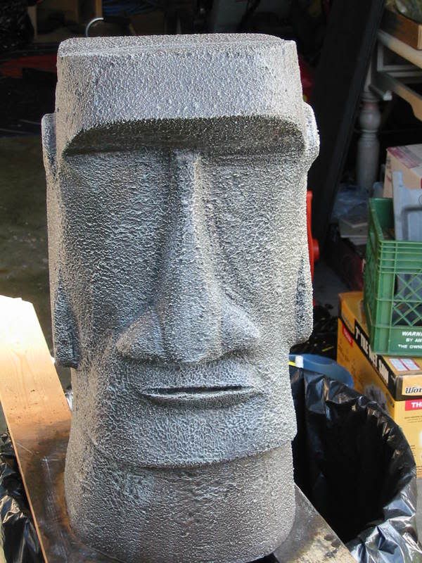

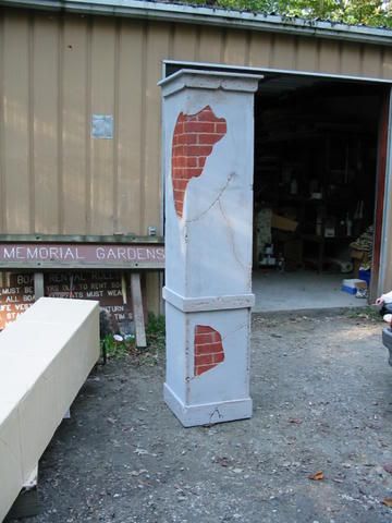

Completed projects:
http://i2.photobucket.com/albums/y28/s_hasty/GatePillar.jpg
http://i2.photobucket.com/albums/y28/s_hasty/Picture159.jpg
http://i2.photobucket.com/albums/y28/s_hasty/Picture177.jpg
The floral foam takes enamels and acrylics and the pink/blue foam only takes acrylics or water based paints. The gate pillar was painted with latex paint and Apple Barrel acrylics.
