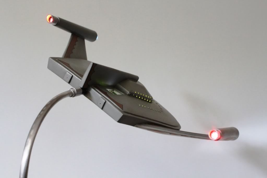

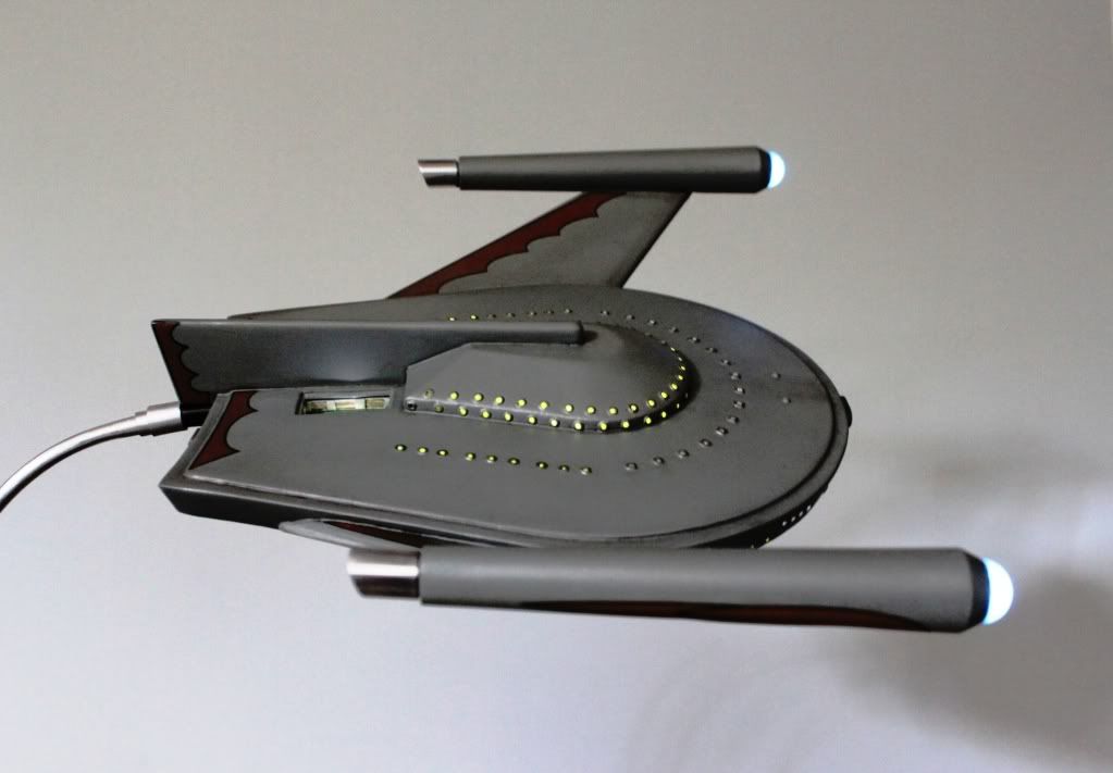

Since CL isn't around anymore thought I might go ahead and post a few pics of my own effort at acccurizing the reissued AMT kit.
It's not 100% accurate to the drawings CL was working from (the same drawings I used) but I'm pretty happy with it:
I even added my own scratch-built fighter called a Talon.

That looks very good Trek!! Let me ask, did you make the stand arm out of different diameter tubing? I really like that.
HAL9001-
Thanks HAL. Yes, the original stand had an aluminum neck with two sizes of Evergreen tubing. I used plastic tubing since it was the only tubing I had in the right diameter to fit around the circumference of the black power plug cover. Unfortunatley the weight of the model (with all the brass and batteries) caused the plastic to crack and break off leaving the model dangling from its wires! :(
I fixed the problem by filing and sanding down the black plastic plug cover until I coudl slide a section of aluminum tubing over it and bond it with epoxy. The "new" neck is much stronger than before.

Amazing work--I don't think I'd even attempt this with the AMT model; I'd rather work off something a lot closer to the actual shape, but I also wouldn't want to tackle a vacuform!
480 Posts
Looks amazing, great work! Hope this ship gets redone some day with many of the features you and CL have incorporated!
