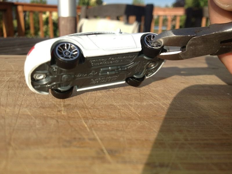

So first I start out buly cutting off one wheel on each side with a pair of cutters of the car to receive the swap.

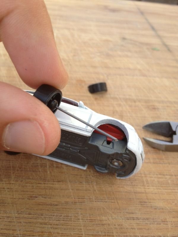

Then clip off one of the ends so you can remove the axle and wheels as you will want to save the axle to possibly use later.

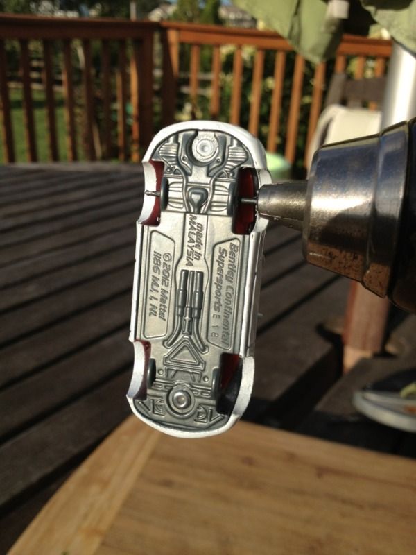

Next you will drill out the axle slot just to widen it enough for the 1/64 OD axle tubing. Use a 1/64 drill bit that matches the tubing OD

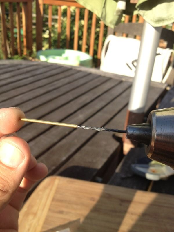

Next you will want to take the axle tube and insert it to get the length and cut to length. The best way Ive learned is to use a razor knife and roll it with medium pressure on a cutting board or surface you don't mind marring. (hint: don't use the kitchen table)
