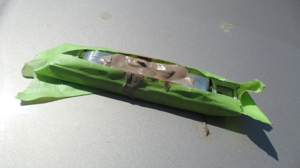

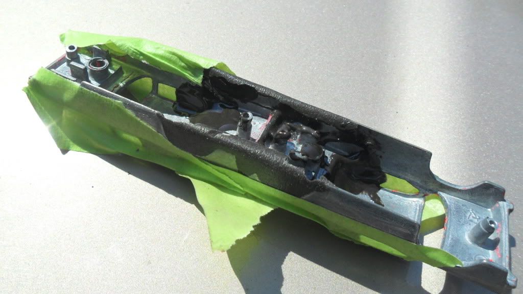

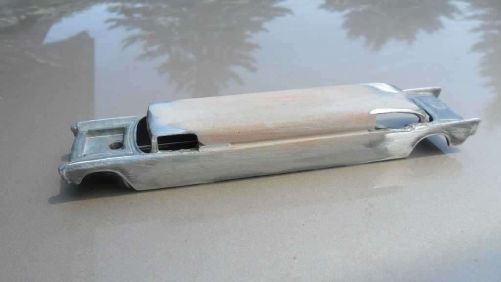

I use a flat steel plate with masking tape on it to get it flat JB wont stick to the tape, grind the ends to be glued and butt the 2 cars together, after its dry, then I put some tape on the outside off body and more JB on the inside of the cars around wheel wells, the tape makes a good mold, I jb all the indide holes and part of the side windows, tape up the side again and fill it in with bondo, I use a tinning agant so the bondo runs into the shape, again the tape makes a good mold for the sides, I need a little extra bondo and I ruff sand with 100 grit to make the shape, I file out the window size I need. It has some primmer on it but I wont get to work on it for 2 weeks to finish up with some more pics
