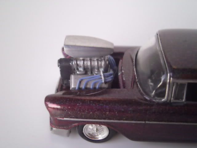

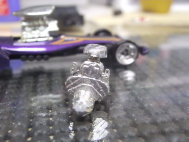

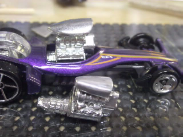

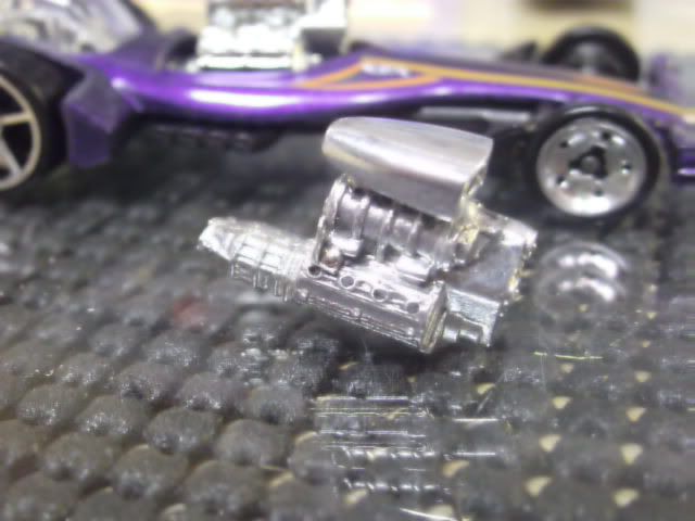

This is a engine that I use from HW "Madfast" seen in the back ground. I saw the potential in this engine for its correct look, detail and because it wasn't plastic. (Plastic is cool, but casted is better). I first ground down the hood scoop to a believable shape and polished it out, This is a hour or better project itself. Then carefully drilled out all of the spark plug holes so that I would be able to wire the engine. (I went through a lot of rasps bits to accomplish this). I then fabricated tiny wire seperators shaped like a L brackets and mounted them on the engine using holes that I drilled (using the high speed rasps and my dremel) on the engine and the wire separator brackets. Small straight pins were used to mount the brackets. Poof engine ready for wiring. Vernon
