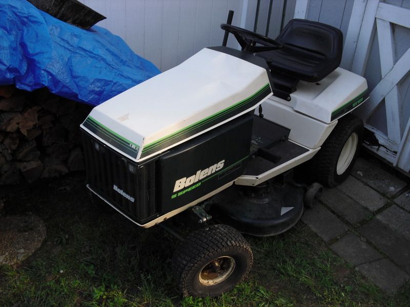

I have a Bolens st120 lawn tractor. It has a 12hp briggs I/C motor. The person I got it from ran something over and it wouldn't restart. The motor is backfiring out of the carb. This is my first small engine project and trying to learn as much as possible. Any help would be greatly appreciated... sorry about the dog bark in the video.

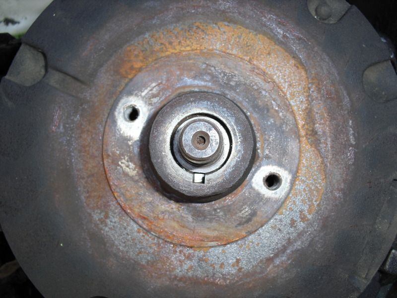

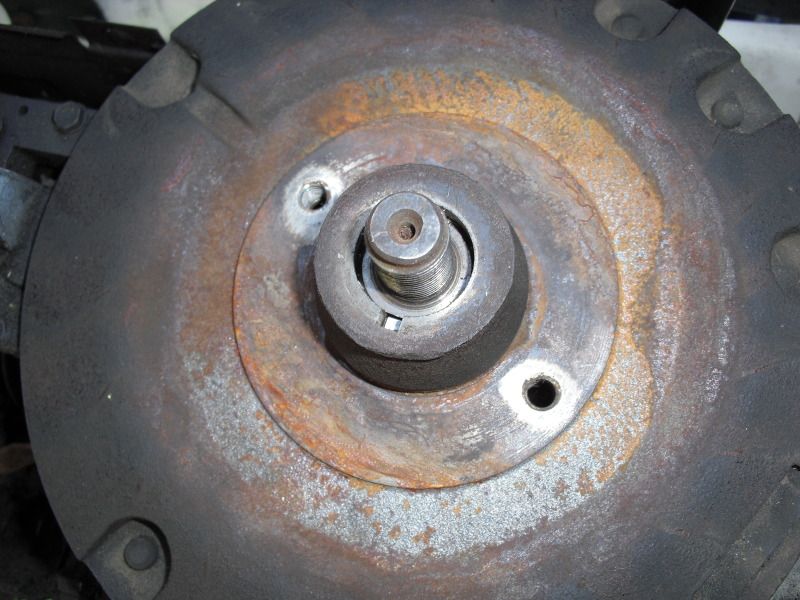

Someone told me to check the flywheel key so I striped it down and took a few pics since I dont know what it should to look like.

I removed the flywheel and the key looks good and was seated correctly between the crank and the flywheel.
6,116 Posts
The problem most likely is in the valves. I would pull the head and check the valve seat, make sure it's not loose in the block. If that looks good, then check the valve lash. L-Head engines can loose clearance over time on the valves.
